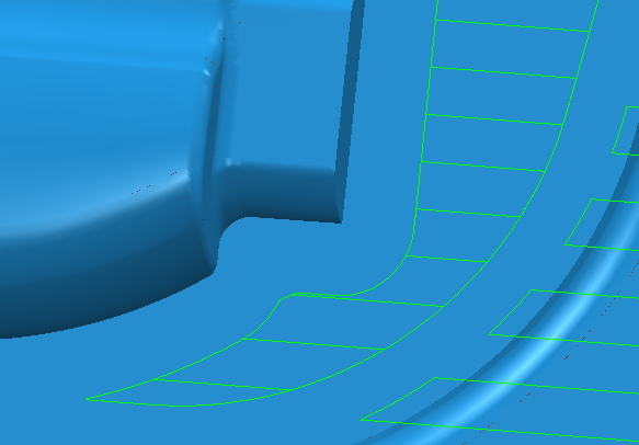

With a Radius of 0.2:

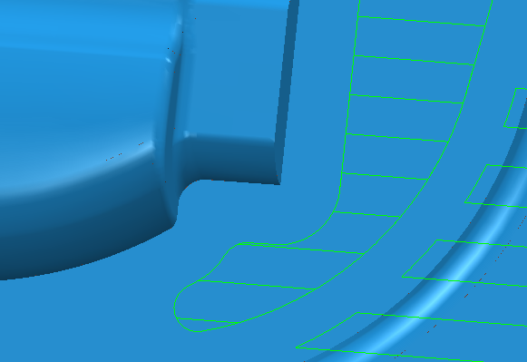

With Profile smoothing deselected:
