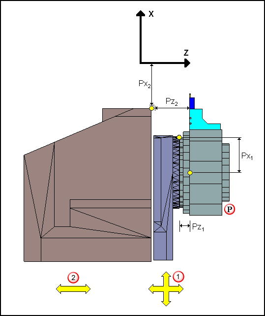

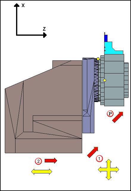

The following diagrams illustrate how to set up the Motion Axes and Model Origin Coordinates for a turret with two components – a slide and a block:
Motion Axes:
The slide has both its X and Z axes enabled (shown by the yellow arrows).
The block has only its Z-axis enabled.
The turret moves in both the Z axis and the X axis (shown by the red arrows).
Because the slide has the Z and X axes enabled, it moves directly with the turret. The block only has its Z-axis enabled (X is disabled) so when the turret moves in the Z and X axes, the block follows only in Z while maintaining a constant X position.
The slide has both its X and Z axes enabled (shown by the yellow arrows). Both its X-axis
Model Origin Coordinate (Px1) and its Z- axis
Model Origin Coordinate (Pz1) are relative to the origin of the turret (
The block has its Z-axis enabled and its X-axis disabled. The Z-axis
Model Origin Coordinate (Pz2) is measured from the origin of the turret, as this axis is a moving axis. The X-axis
Model Origin Coordinate (Px2) is measured from the Machine Origin as the X-axis is a non-moving axis for the block component.
