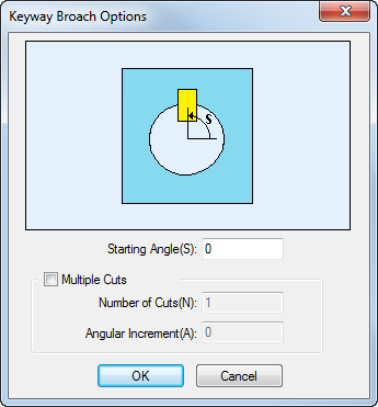

Use the Keyway Broach Options dialog to set the starting angle for the Keyway Broach tool.
To display the Keyway Broach Options dialog, click Keyway Broach Options on the Edit Hole Operation dialog when you have Keyway Broach selected as the Operation Type on the Cycles Data dialog.
The following settings are available:
Starting Angle (S) — Enter the angle by which to index the stock before the start of the broaching process.
Multiple Cuts — Select this option if you want to include multiple indexes of the stock within the operation.
Number of Cuts (N) — Enter the number of times you want the stock to index to broach the shape in the operation. This field is available only if Multiple Cuts is selected.
Angular Increment (A) — Enter the angle by which you want to index the stock between each cut. This field is available only if Multiple Cuts is selected.
