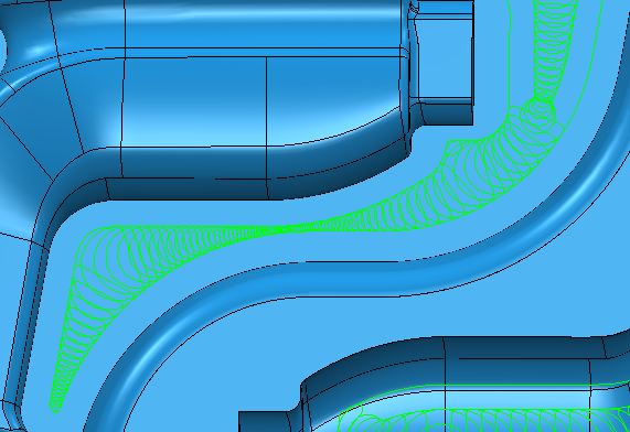

Profile smoothing — All Vortex toolpaths use arc fitting of profiles to avoid sharp changes of direction in internal corners.
Radius (tool diameter units) — Enter the radius as a proportion of the tool diameter. The value you enter determines when PartMaker inserts arcs.
The default value is 0.05. So, if you have a tool of diameter 20 mm (radius 10 mm) then the arc radius is 1 mm.
Using a Radius of 0.2 produces:
Using a Radius of 0.05 produces:
You can see that a small Radius value produces more trochoids.
