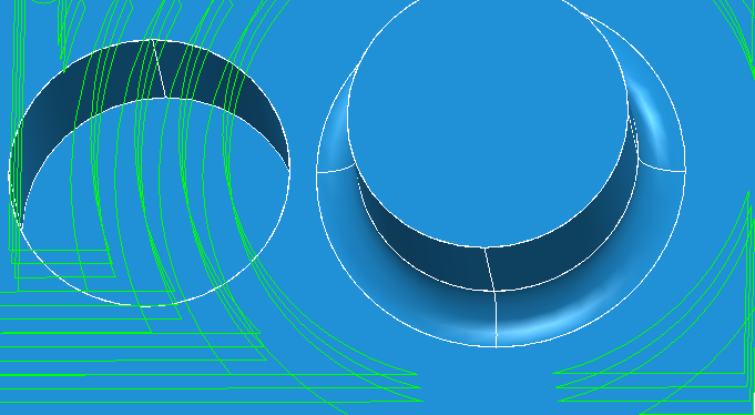

Remove segments smaller than threshold option deselected:
Remove segments smaller than threshold selected:
Removes the small segments in areas
