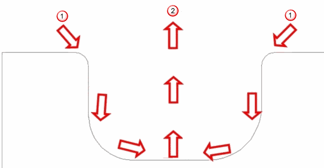

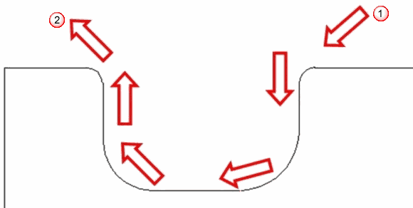

Finishing Path Method — Select the method you want to use for finishing the general groove:
Start points
End point
Start point
End point
