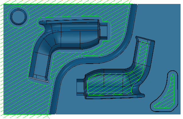

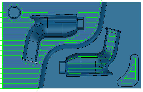

For example:
Select Fixed direction
Enter an Angle of 0
Enter an Angle of 30

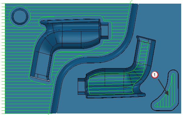

Deselect Fixed direction
In this case, most of the toolpath has an Angle of 0
, but pocket
has an Angle of 90
