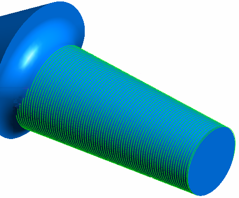

Spine finishing projects a tubular pattern onto the model, which is then machined. The curve that is used as the center of this tube (the focus of the pattern) is known as a Spine curve.
This strategy is useful for machining parts whose natural axis of symmetry is bent, such as bent pipes.
This strategy supports Spine curves.
