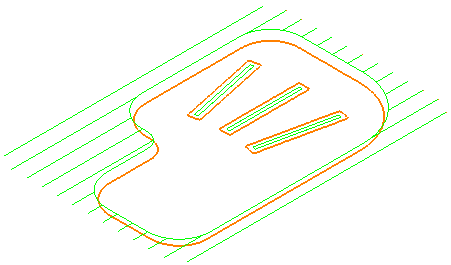

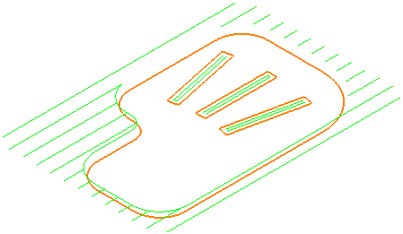

Minimize full width cuts — Select to remove (as far as is possible) all raster moves that could cause the tool to cut on its full width. Due to the searching nature of the raster pattern, the tool may occasionally be cutting on its full width. This is not generally a problem when cutting soft material, but can cause tool damage when machining hard material.
Machine all raster spans — Select to machine all raster spans. When deselected, unnecessary raster spans are left unmachined. For high speed machining, it is best to have this option selected to ensure an even loading on the tool.
An unnecessary raster span is one where the tool either doesn't remove any material or doesn't remove any material that a future pass would not remove. This can happen on the first and possibly the last raster span of an area, and where the raster spans are shorter than the diameter of the tool.
