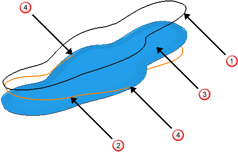

All the toolpaths are generated using:
— top pattern
— bottom pattern
— limiting surface
— intersection of the bottom pattern with the limiting surface

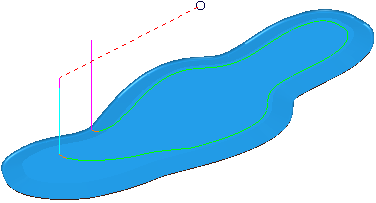

Upper limit of None:

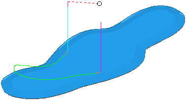

Upper limit of Top, and an Offset of -12:
