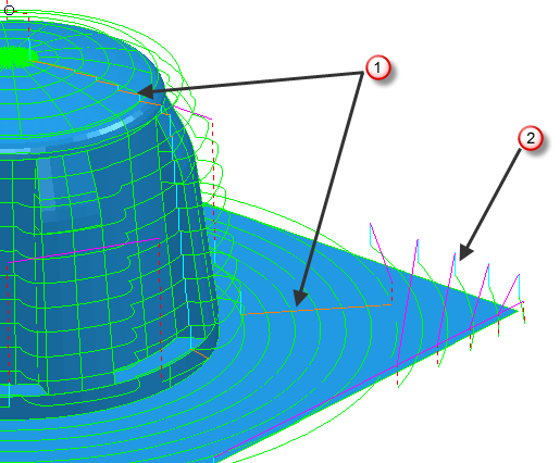

Short links
Long links
Short/Long Threshold — Enter the distance at which a short link becomes a long link.
Short — Select the type of link moves to connect consecutive cutting passes for links shorter than the Short/Long threshold value.
Short link of Straight
Default link of Skim
Where the short links gouge the Default link is used.
Long — Select the type of link moves to connect consecutive cutting passes for links longer than the Short/Long threshold value.

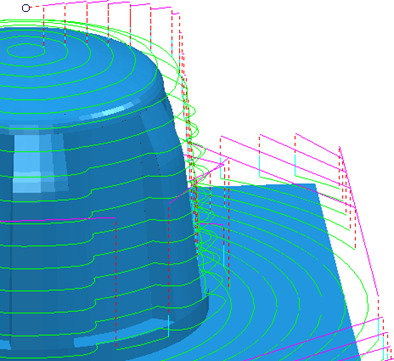

This toolpath has Retract and Approach Moves set to 0:

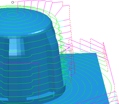

This toolpath has Automatically extend selected:
This toolpath has Automatically extend deselected and a Retract and Approach distance of 10:

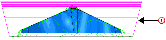

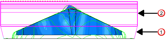

Retract along tool axis.

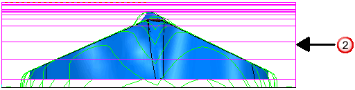

Retract normal to the safe plane.
