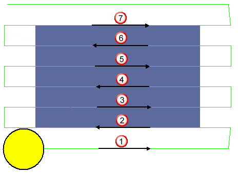

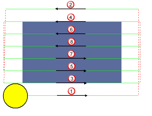

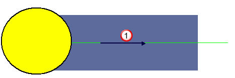

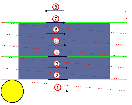

Style — Select the style you want to use:
Depending on the stepover, the last pass of the path may be in the opposite direction to facilitate the removal of burrs.
Toolpath Direction — Select the direction of the toolpath. This is available only when Linear is selected as the Style.
