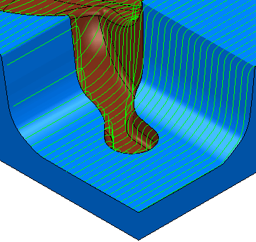

No Perpendicular pass
Perpendicular pass — Deselected.
This creates one raster pass over the whole part.
Perpendicular pass, Shallow angle 0
Perpendicular pass — Selected.
Shallow angle — 0.
Optimize parallel pass — deselected.
This creates two perpendicular raster passes over the whole part.
Perpendicular pass, Shallow angle 5
Shallow Angle — 5.
Optimize parallel pass — Deselected.
This creates one raster pass over the entire model and a second pass, perpendicular to the first, which machines only the areas of the model that are steeper than the Shallow angle.
Optimize parallel raster
Perpendicular pass — selected.
Shallow angle — 5.
Optimize parallel pass — selected.
Both passes are limited, whereas when the Perpendicular pass is selected and Optimize parallel pass deselected, only the second pass is limited. The first raster pass:
The second perpendicular pass is restricted to the steep areas where the first pass didn't clear the material effectively.
