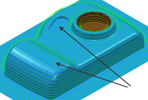

Fixed direction —Select to specify the angle of passes in the Angle field. When deselected, PartMaker automatically calculates the most appropriate angle.
Select Fixed direction
Enter an Angle of 0:

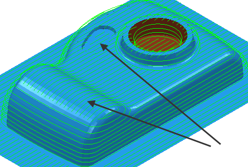

Deselect Fixed direction:

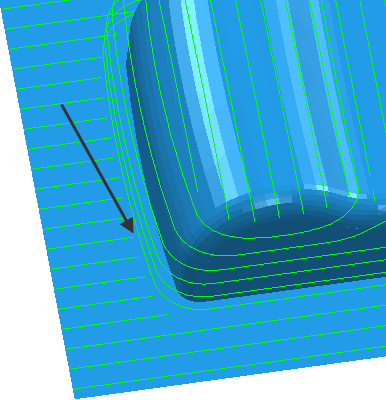

Wall clearance —Enter the clearance to be used to prevent raster spans at the bottom of a steep area from hitting that steep area. This prevents dwell marks on the steep areas.
