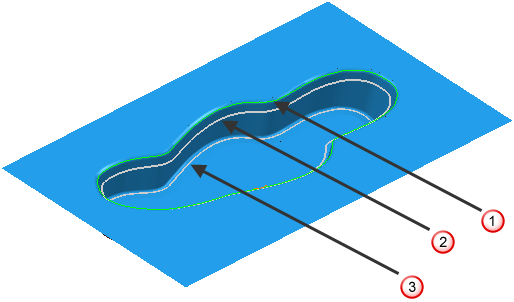

Use the Position page to determine the location of the toolpath.
Lower limit

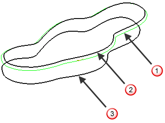

Base position —Select the position of the toolpath.
— Toolpath
— Top pattern
— Bottom pattern

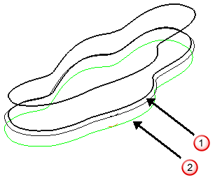

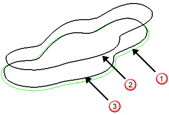

Offset —Enter an offset value. PartMaker uses this value to offset the lowest position of the toolpath along the tool axis from the position defined in Base position.
An Offset of 0.
An Offset of 10.
