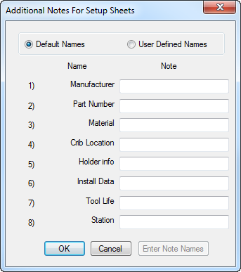

Use the Additional Notes for Setup Sheets dialog to add up to eight additional notes about the current tool. These notes are included in any setup sheets you generate that include this tool.
To display this dialog, click the Additional Notes button (>>) in the Tools Dataor Edit Tool dialogs.
The following options are available:
Default Names — Select this option to use the note names (for example, Manufacturer and Part Number) that come as standard in PartMaker.
User Defined Names — Select this option to enter your own names for notes. You can then click the Enter Note Names button to display the Enter Note Names dialog, where you can enter your own names for notes
Note — Enter the additional tool information for each note in the Note fields.
