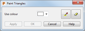

- Click Manage tab > Triangles panel > Paint to display the
Paint Triangles dialog:
- Select the colour you want to paint the triangles:
- Click
and select a colour from the palette. Alternatively, select
Other to display the
Colour dialog, and create a custom colour by specifying the values for
Hue,
Sat (saturation),
Lum (Luminosity),
Red,
Green, and
Blue.
- Click the
Pick Colour
button to pick a colour already used in the mesh. The picked colour is displayed in the
Use colour box.
- Click
Apply
to paint the selected triangles.

- When you have finished painting triangles, click
OK to save your changes and close the dialog.
Note: Cancel deletes unapplied changes and closes the dialog.
