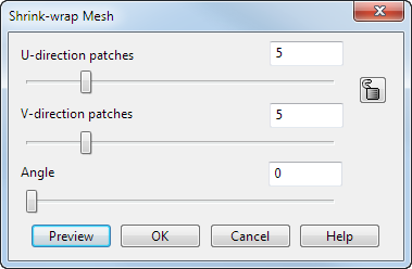

The Shrink-wrap option enables you to generate a non-primitive surface and automatically trim it to fit a mesh.
To generate a shrink-wrap surface:

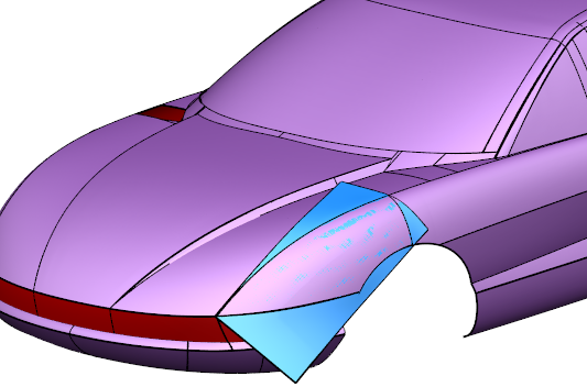

As you drag the slider, the surface rotates around the active workplane. For example:

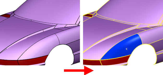

Before alignment
After alignment

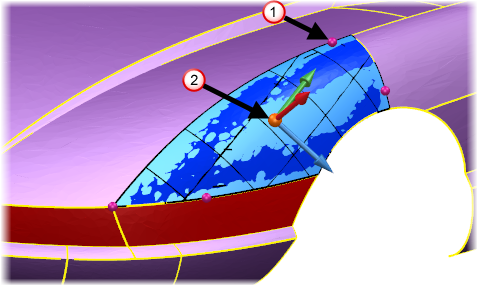

You can also click and drag the graphic handles
to rotate the surface around the temporary workplane
A preview
is displayed that shows the lateral and longitudinal directions for the re-aligned surface.
Before alignment
After alignment

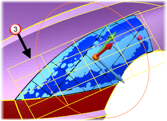

A preview
Click Preview to preview the surface.
Click OK to create the surface and close the dialog.
