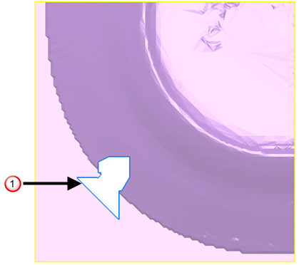

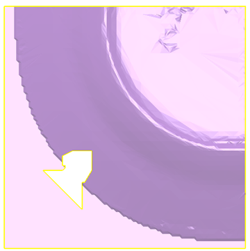

You can fill holes in mesh models using the Fill Hole option and selecting the open boundaries.

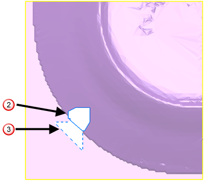

If the hole to be filled covers an area of different curvature, split the hole into smaller regions, and fill them separately. This allows more complicated holes to be fixed without the need for full manual triangle-editing. After selecting a hole to fill, you can pick two points on the boundary to split the hole into two regions. If the wrong side is highlighted by default, click to select the region that you want to fill.
Using the model below as an example, fill the hole in two parts, filling the flat area with a planar cap, and the curved area with a curvature cap:

. The selected boundary turns blue:
. The alternative selection is outlined by a dashed blue line
. Swap the selection by clicking the outline of the region required:
