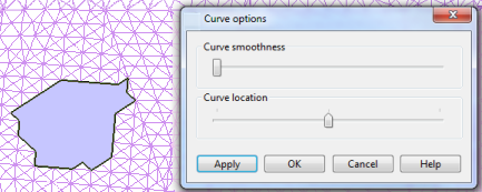

- Click Mesh Tools tab > Create panel > Boundary to create the curve at the boundary of the selected mesh, and to display the
Curve options dialog:
- Move the
Curve smoothness slider to smooth the curve.

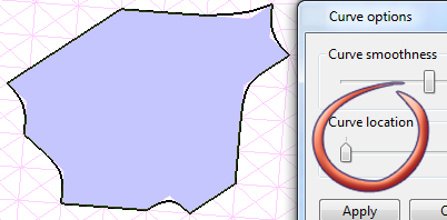

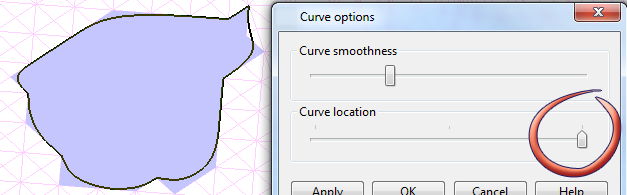

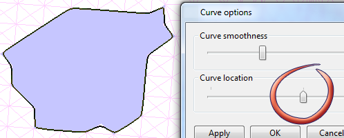

Curve location slider to adjust the position of the curve relative to the area enclosed. There are three positions for the curve:
- Outside— The curve encloses the selected triangles.
- Average— Some triangles are within the curve and some are outside the curve.
- Inside — The curve is enclosed within the selected triangles.
