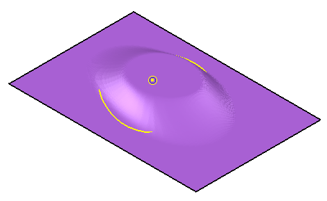

This shows the following changes:
- The inner region is moved upwards by 5.
- Blend area (between the two contours) is created using the smoothing algorithm.

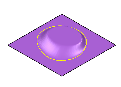

This shows that:
- The outer region is scaled by 1.5.
- The region is not scaled in the X direction.
