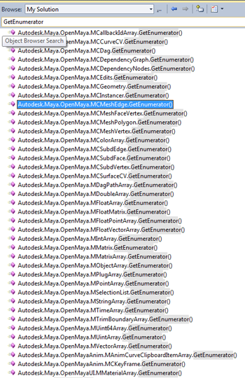

Many classes in the Maya .NET API implement the IEnumerable<T> interface. Some examples include helper classes like MCGeometry, MCDag, and MCDependencyGraph, as well as the various Maya array classes such MColorArray, MFloatPointArray, and so forth. To see all classes that implement IEnumerable<T> you can use the Object Browser to search for GetEnumerator().
Any class that implements a GetEnumerator() function (including functions that implement IEnumerable) and returns a class that conforms to the IEnumerator interface can be used with the foreach keyword. For example, with objects selected in the scene, the following code snippet displays the path names of all selected objects.
