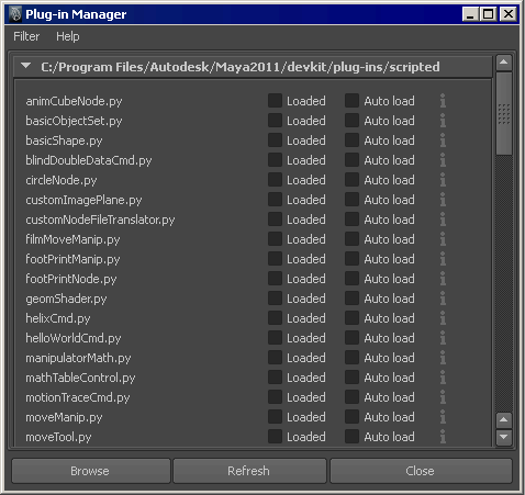

Scripted plug-ins
Scripted plug-ins allow a developer to create a solution that is tightly coupled with Maya. Scripted plug-ins allow a developer to support functionality such as the undoing of commands and the building of appropriate requires lines into the Maya scene file. Another advantage of using a scripted plug-in is that its functionality is available in both MEL and Python.
Using a scripted plug-in
We have extended the Maya Plug-in Manager to support the loading and unloading of scripted plug-ins.
Any file ending with a .py extension that is on the MAYA_PLUG_IN_PATH is displayed in the Plug-in Manager. Select the Loaded check-box or the Auto load check box to either load or auto-load the scripted plug-in.
Note: Although, it is possible to have a non scripted plug-in .py script on the MAYA_PLUG_IN_PATH, these items will not load. Warnings will be issued that entry points cannot be found.
The plug-in can either be loaded from the Plug-in Manager or from the MEL or Python command tabs. In MEL, use the loadPlugin() command. In Python, use the maya.cmds.loadPlugin() command
To run an example such as helixCmd.py, load the plug-in and enter the following in the Python Editor tab:
