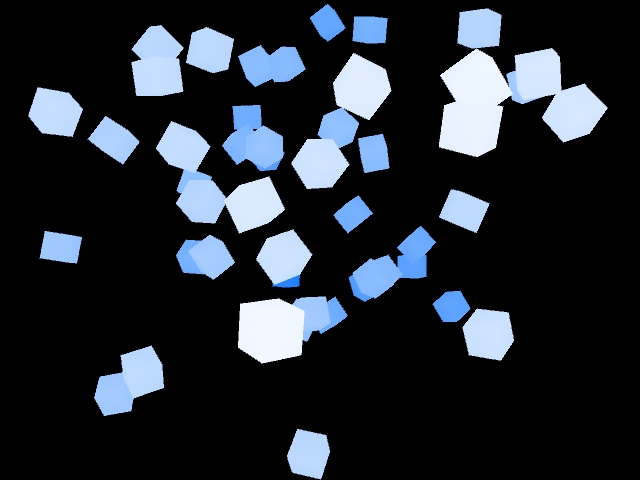

Filename: depthShader.py
Rendered Output:
Program Summary: The plug-in code below creates a new depth shader by inheriting from the OpenMayaMPx.MPxNode class. This shader can only be used by the Maya software shader. The compute() method is run for every rendered surface point, and determines the pixel's color based on the surface point's Z-axis distance from the camera.
To access the depth of each rendered surface point, we create the following numeric attribute in nodeInitializer():
depthShader.surfacePointAttribute = numericAttributeFn.createPoint('pointCamera', 'p')The name of this attribute ('pointCamera'), and its short name ('p'), are very important here, because they allow Maya to automatically connect our shader node to the samplerInfo node's pointCamera output attribute. The samplerInfo node provides vital information about the point being rendered. For a full list of its attributes, consult the Maya User Guide > Technical Documentation > Nodes > samplerInfo. You may also wish to consult the Appendix C: Rendering attributes in the API Documentation for a detailed list of other rendering attributes.

# Sample usage.
# Copy the following lines and run them in Maya's Python Script Editor:
import maya.cmds as cmds
import random
# Load our plug-in.
cmds.loadPlugin( 'pyDepthShader.py' )
# Clear the scene.
cmds.file( new=True, force=True )
# Create an instance of our depth shader.
depthShaderName = cmds.shadingNode( 'pyMyDepthShader', asUtility=True )
cmds.setAttr( depthShaderName + '.gamma', 1.4 )
cmds.setAttr( depthShaderName + '.farColor', 0, 0.43, 1, type='double3' )
# Create a surface shader to which we will attach our depth shader.
surfaceShaderName = cmds.shadingNode( 'surfaceShader', asShader=True )
cmds.connectAttr( depthShaderName + '.outColor', surfaceShaderName + '.outColor', force=True )
# Create a shading group to tie everything together.
shadingGroupName = cmds.sets( name='surfaceShader1SG', empty=True, noSurfaceShader=True, renderable=True )
cmds.connectAttr( surfaceShaderName + '.outColor', shadingGroupName + '.surfaceShader', force=True )
# Create a bunch cubes pseudo-randomly placed according to a seeded random number generator.
numCubes = 50
positionRange = 14
randomSeed = 5
random.seed( randomSeed )

# Sample usage.
import random
# Load our plug-in.
cmds.loadPlugin( 'depthShader.py' )
# Clear the scene.
depthShaderName = cmds.shadingNode( 'myDepthShader', asUtility=True )
numCubes = 50
positionRange = 14
randomSeed = 5
for i in range( 0, numCubes ):
# Create a new cube.
newCubeName = cmds.polyCube( w=2, h=2, d=2 )
# Move the cube somewhere near the grid.
cmds.move( random.randint( -positionRange, positionRange ), # x
random.randint( -positionRange, positionRange ), # y
random.randint( -positionRange, positionRange ), # z
newCubeName )
# Rotate the cube along all three axes.
cmds.rotate( random.randint( 0, 360 ), # x axis
random.randint( 0, 360 ), # y axis
random.randint( 0, 360 ), # z axis
newCubeName )
# Assign the cube we have created to our surface (depth) shader.
cmds.sets( newCubeName, e=True, forceElement=shadingGroupName )
# Render the current view.
cmds.render()
