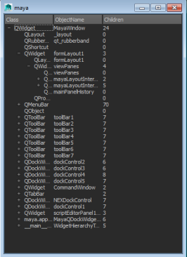

PySide example scripts
A few example scripts are provided in the devkit/pythonScripts folder of your Developer Kit installation that demonstrate the fundamental concepts for creating basic PySide scripts. See Setting up your build environment: Windows environment (64-bit).
Running the example scripts
You can run the example scripts by using the execfile command in the Python tab of your Script Editor as follows:

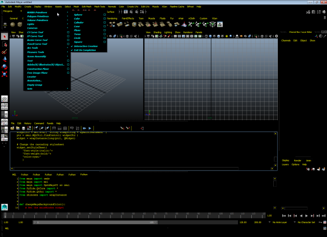

Customizing the color of the Maya widgets
The editMayaWidgets.py script below demonstrates how to customize the colors for Maya's main window and menus.
The standard Maya imports are as follows:
from maya import cmds
from maya import mel
from maya import OpenMayaUI as omui
In addition, include these imports for PySide:
from PySide2.QtCore import *
from PySide2.QtGui import *
from PySide2.QtWidgets import *
from shiboken2 import wrapInstance
Note: You may want your script to be compatible also with versions of Maya earlier than Maya 2017. One way of doing this is to import from PySide as follows:
try:
  from PySide2 import __version__
except ImportError:
  from PySide.QtCore import *
  from PySide.QtGui import *
  from PySide import __version__
  from shiboken import wrapInstance
To obtain the Maya main window widget as a PySide widget, do as follows:
omui.MQtUtil.mainWindow()
ptr = omui.MQtUtil.mainWindow()
widget = wrapInstance(long(ptr), QWidget)
This script demonstrates how to edit the style sheet to change the Maya background color:
def changeMayaBackgroundColor(background='black', color='yellow'):
    widget.setStyleSheet(
        'background-color:%s;'%background +
        'color:%s;'%color
This script also demonstrates how to get a Maya control (in this case, the Create menu) as a PySide widget by first evaluating a MEL string in Python, and then using maya.OpenMayaUI.MQtUtil.findControl().
widgetStr = mel.eval( 'string $tempString = $gMainCreateMenu' )
ptr = omui.MQtUtil.findControl( widgetStr )
You can change the font style and weight for your menus (in this case, the Create menu) by editing the Qt stylesheet as follows:
def changeMayaMenuColors(fontStyle='italic', fontWeight='bold', fontColor='cyan'):
        'font-style:%s;'%fontStyle +
        'font-weight:%s;'%fontWeight +
        'color:%s;'%fontColor

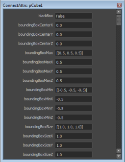

Creating a basic Attribute Editor
The connectAttr.py script demonstrates how to create a basic Attribute Editor that updates the attribute values, and is updated when attributes change. This way, the attribute values and control values stay in sync.
It uses mayaMixin for its dockable functions, as well as QFormLayout and QScrollLayout to create the Qt UI.
Import the mayaMixin module as follows:
from maya.app.general.mayaMixin import MayaQWidgetBaseMixin, MayaQWidgetDockableMixin
This example derives from the MayaQWidgetDockableMixin and QScrollArea classes to create the container widget and the attribute widgets:
class Example_connectAttr(MayaQWidgetDockableMixin, QScrollArea):
    def __init__(self, node=None, *args, **kwargs):
        super(Example_connectAttr, self).__init__(*args, **kwargs)
        # Member Variables
        self.nodeName = node               # Node name for the UI
        self.attrUI = None                 # Container widget for the attr UI widgets
        self.attrWidgets = {}              # Dict key=attrName, value=widget
It then uses the MayaQWidgetDockableMixin class show() method to show the widget and set the window as dockable and floating.
ui = Example_connectAttr(node=obj)
ui.show(dockable=True, floating=True)
It then uses QFormLayout to create a 2-column form widget, with an attribute name string and an attribute widget.

    # get widget associated with the attr
    widget = self.attrWidgets.get(attrName, None)
    if widget != None:
        # get node.attr string
        nodeAttrName = plug.partialName(True, False, False, False, False, True)
        # Add to the dict of widgets to defer update
        self._deferredUpdateRequest[widget] = nodeAttrName
        # Trigger an evalDeferred action if not already done
        if len(self._deferredUpdateRequest) == 1:
            cmds.evalDeferred(self._processDeferredUpdateRequest, low=True)
def _processDeferredUpdateRequest(self):
    '''Retrieve the attribute value and set the widget value
    for widget,nodeAttrName in self._deferredUpdateRequest.items():
        v = cmds.getAttr(nodeAttrName)
        widget.setText(str(v))
        print "_processDeferredUpdateRequest ", widget, nodeAttrName, v
    self._deferredUpdateRequest.clear()
Creating a Qt widget with a tree list view
The widgetHierarchy.py script demonstrates how to create a Qt widget that lists all the Qt widgets used in Maya.
The tree list is created by deriving from MayaQWidgetBaseMixin and QTreeView:
class WidgetHierarchyTree(MayaQWidgetBaseMixin, QTreeView):
    def __init__(self, rootWidget=None, *args, **kwargs):
        super(WidgetHierarchyTree, self).__init__(*args, **kwargs)
This example demonstrates how to delete a widget when it is closed:
self.setAttribute(Qt.WA_DeleteOnClose, True)
It sets up for populating the hierarchy tree by setting the root widget:
# Determine root widget to scan
if rootWidget != None:
    self.rootWidget = rootWidget
else:
    mayaMainWindowPtr = omui.MQtUtil.mainWindow()
    self.rootWidget = wrapInstance(long(mayaMainWindowPtr), QWidget)
To populate the tree view, the example calls QStandardItem for each column and recurses through the child widgets:
def populateModel(self):
    # Create the headers
    self.columnHeaders = ['Class', 'ObjectName', 'Children']
    myModel = QStandardItemModel(0,len(self.columnHeaders))
    for col,colName in enumerate(self.columnHeaders):
        myModel.setHeaderData(col, Qt.Horizontal, colName)
    # Recurse through child widgets
    parentItem = myModel.invisibleRootItem();
    self.populateModel_recurseChildren(parentItem, self.rootWidget)
    self.setModel( myModel )
def populateModel_recurseChildren(self, parentItem, widget):
    # Construct the item data and append the row
    classNameStr = str(widget.__class__).split("'")[1]
    if pysideVersion == '1.2.0' :
      classNameStr = classNameStr.replace('PySide.','').replace('QtGui.', '').replace('QtCore.', '')
    else:
      classNameStr = classNameStr.replace('PySide2.','').replace('QtGui.', '').replace('QtCore.', '').replace('QtWidgets.', '')
    items = [QStandardItem(classNameStr),
             QStandardItem(widget.objectName()),
             QStandardItem(str(len(widget.children()))),
    parentItem.appendRow(items)
    # Recurse children and perform the same action
    for childWidget in widget.children():
        self.populateModel_recurseChildren(items[0], childWidget)
