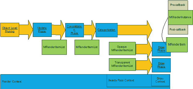

The pipeline in which the update and draw phases reside could look as follows:
Figure 27
In the figure above, some of the abstract constructs from the previous diagram have been replaced with constructs exposed in the API. The Update Phase produces MRenderItems (and their associated MShaderInstances). The transparency indicator on the MShaderInstance is taken into account during the consolidation and categorization phases so that the render item may be being transferred to a “transparent” render item list. During the Draw Phase, the MRenderItem is examined. The corresponding MShaderInstance sets up the shader and updates the actual hardware shader based on the parameter values of the MShaderInstance. Geometry referenced in the MGeometry will be bound and drawn. Any pre or post callback associated with the MShaderInstance would be invoked at the appropriate times.
