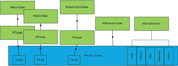

The following diagram shows the logical connections between state and the overall rendering context. Blending is a property of a color target; depth and stencil state is a property of a depth+stencil target stage; sampling is a prop­erty per shader stage; and rasterization is a render context property.
Figure 33: Two blend states are shown for two different color targets and a depth+stencil state is shown for a depth+stencil target. Each shader could have a different sampler state and there is a per context rasterization state relationship.
