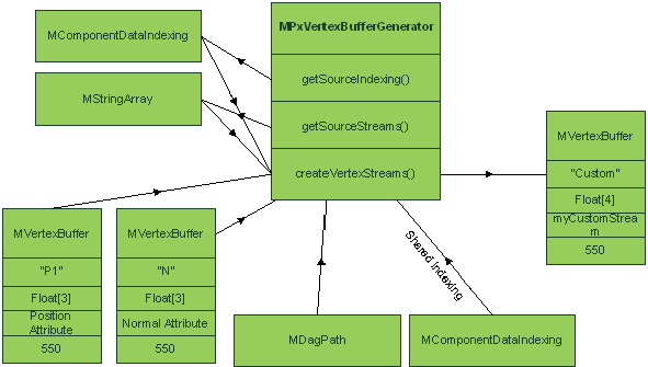

A generator is called to fill in data via its createVertexStreams() method. For the given DAG path, the generator updates and returns an MVertexBuffer.
A set of existing source streams can be supplied for situations where new data is generated based on existing data. The specific streams that are required are returned via a query to the generator (getSourceStreams()) before createVertexStreams() is invoked.
As an example, existing position and normal streams can be combined to form a new stream. Since the input streams (MVertexBuffers) are GPU resources, they need to be mapped to CPU memory before they can be read from. Any source stream data should never be modified.
In order to fill in the data correctly, the indexing which is used to reference the data stream is also provided. The generator provides the desired indexing for the custom stream (getSourceIndexing()). It is possible that indexing optimization may be performed based on the indexing for all internal and custom streams. Both the original and the shared indexing data are provided to the generator at stream creation time. Indexing is specified using an MComponentDataIndexing instance. This is a wrapper for a set of index values and a component type.
It is the responsibility of the generator to perform the correct allocation and transfer of data into the MVertexBuffer that it is supplied.
Figure 69: The flow of execution is roughly shown based on the ordering of the methods on the buffer generator. From the top downwards, source stream and indexing requirements are queried. At creation time any requested source streams, the relevant dag path and the overall shared indexing are provided as inputs. The generator is responsible for filling in the MVertexBuffer. In this case, it swizzles an input position and a normal stream into a new stream.

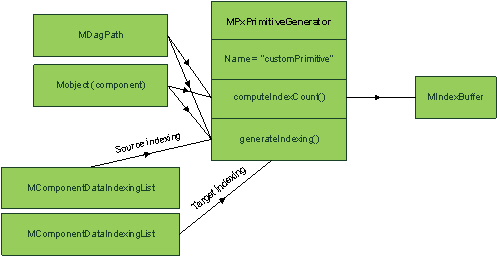

Custom stream indexing should be provided using an: MPxPrimitiveGenerator.
As with stream generators a unique name is used to identify the indexing that can be used. For indexing, a shader instance specifies the required indexing using a MIndexBufferDescriptor. The primitive name in the descriptor can be set to the name of the primitive generator.
In order to use an MPxPrimitiveGenerator, it needs to be registered via the MDrawRegistry class in a similar fashion to that of an MPxVertexBufferGenerator.
There are two entry points which currently can support adding in indexing requirements: For an MPxShaderOverride this is the point when its geometry requirements are defined and for an MPxGeometryOverride this is the point when geometry requirements are defined for additional render items. In either case, the requirements are specified by a MIndexBufferDescriptor.
To add custom indexing as a requirement, an appropriately set up MIndexBufferDescriptor must be added. The type must be set to “custom” and a unique name set. This name should match the name of a registered generator.

Figure 70: Resulting relationship based on code example.
When custom indexing is required the appropriate calls to a generator instance are made. The generator first provides the indexing size relative to a DAG object and DAG component (computeIndexingCount()). The generator is then asked to create the actual indexing. The source and target indexing data is also provided. An MIndexBuffer must be updated and returned. As this is a GPU resource, it must be mapped back to CPU memory, updated, and then transferred back to GPU memory.

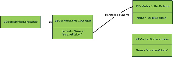

The following diagram illustrates the relationship of the above code example. An additional “customMutator” is added to show the lookup by semantic name.

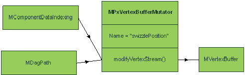

When a mutator is required to perform an update, an associated Maya DAG path and data stream indexing are passed in. An existing MVertexBuffer is passed in for update and data is modified in-place.
Figure 74

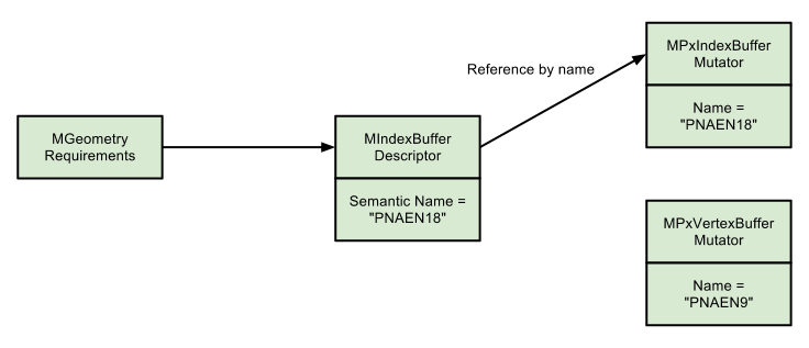

=>An indexing mutator can be used to modify the data for a given existing index buffer (MIndexBuffer). Mutators are associated with a descriptor through name matching between the mutator and the semantic name on a descriptor (MIndexBufferDescriptor)
A mutator is represented as an MPxIndexBufferMutator. Mutators must be registered with MDrawRegistry.
This example illustrates how to specify an existing mutator for use:
MHWRender::MIndexBufferDescriptor indexingRequirement(
MHWRender::MIndexBufferDescriptor::kCustom,
customIndexingMutatorName,
MHWRender::MGeometry::kTriangles);
// Add the descriptor as part of the requirements for this shader
addIndexingRequirement(indexingRequirement);

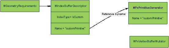

Figure 75
When a mutator is required to perform an update, an associated data stream indexing and previously generated vetex buffer array are passed in. An existing MIndexBuffer is passed in for update and data is modified in-place.
Figure 76

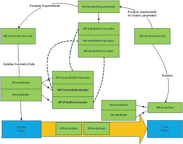

Pipeline Summary:
Figure 77
The above diagram shows how generators and mutators fit in the overall pipeline. Shown is a shader override which has custom requirements (based on shader parameters) for the generation and mutation of vertex buffers, and primitive generation (as represented by the descriptors). When updates need to occur (Update phase), the shader requirements on an MPxGeometryOverride are name matched to generators and mutators which are invoked to update or create vertex and index buffers. These custom buffers can be used by one or more render items which flow down the pipeline until it reaches the Draw Phase. At this point, the custom vertex and index buffers can be bound to the shader parameters which initiated the custom data requirement.
