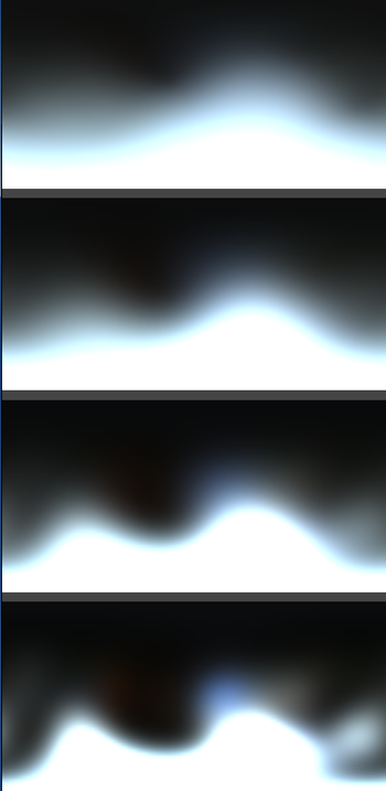

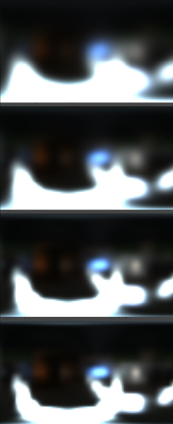

The specular map is a 3d map with each Z slice containing samples at different levels of specularity.
An example is shown below. These images represent the generated specular 3d map with 8 levels of sampling.

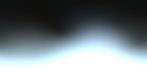

This image represents the generated irradiance 2d texture.

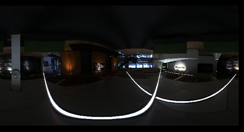

This image shows the input environment texture.

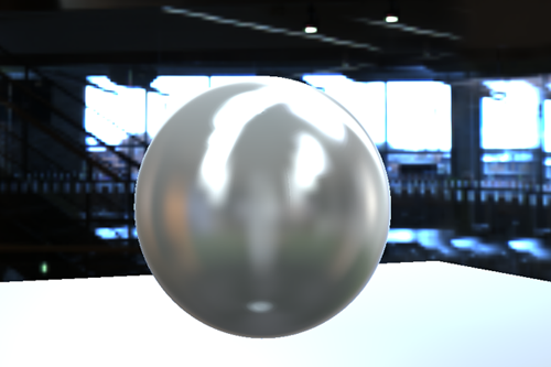

This image represents a blinn shader using the example environment maps, as specified on a plug-in node that is classified as an image light.
