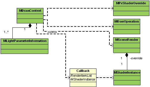

The following diagram shows how an MDrawContext is made available at render time for MPxShaderOverride, MSceneRender and MUserOperation operations as well as for MShaderInstance instances.
Figure 68: Access to lighting information is based on access to a draw context.

            gGLFT->glLightfv(MGL_LIGHT0+i, MGL_POSITION, pos);
            gGLFT->glLightf(MGL_LIGHT0+i, MGL_SPOT_CUTOFF, 180.0);
The current light is then enabled:
        // Enable the light
        gGLFT->glEnable(MGL_LIGHT0+i);
The plug-in example also provides corresponding sample code for disabling lights. See the Developer Kit example for more details.
