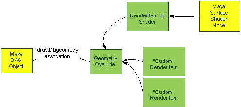

Implementations of MPxGeometryOverride must be registered with MDrawRegistry using classification strings. The classification string must begin with “drawdb/geometry” in order to be properly recognized by the system. DAG objects whose classification string satisfies the override classification string are evaluated using the override. Maya creates one instance of the registered MPxGeometryOverride for each associated DAG object.
Figure 38: An MPxGeometryOverride is associated with a given DAG object by its classification string. Shown is a possible configuration where render items from an internal surface shader as well as custom render items are part of the set of render items that the override would handle.
