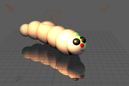

This example creates a Ground Reflections renderer in the Renderer viewport panel menu. When you switch to the Ground Reflections renderer, the viewport updates to render your object and its reflection.
