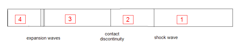

Compressible flow in a shock tube is a classic gas dynamics problem. For ideal flow (no friction), the normal shock relations can be used to determined the shock speed and the conditions downstream of the shock.

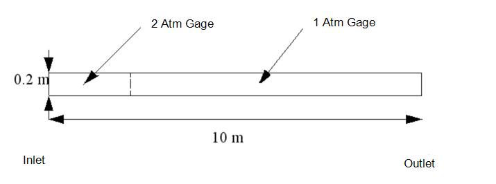

For this verification case a shock tube (10 meters long, 0.2 meters diameter) is modeled with an initial static pressure ratio of 3:2. The initial pressure condition simulates the dividing membrane in a real shock tube. Once the membrane is broken, the higher pressure expands into the low pressure air and a normal shock travels down the tube at a supersonic speed. The shock speed is determined by the initial condition pressure ratio across the membrane.
Geometry and Boundary Conditions
Initial Conditions:
Boundary Conditions:

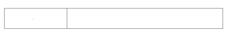

The following figures show the scenarios before the membrane is broken (top) and after it is broken (bottom).
