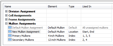

- Click New Mullion Assignment.
A new mullion assignment is displayed in the list of mullion assignments.
New mullion assignment
