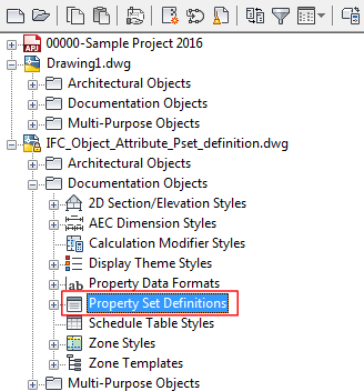

- In the Style Manager, click File
Open.
- Navigate to C:\ProgramData\Autodesk\ACA <version>\enu\Styles and open IFC_Object_Attribute_Pset_definition.dwg.
- On the left pane of the Style Manager, expand IFC_Object_Attribute_Pset_definition.dwg
Documentation Objects
Property Set Definitions.
- From the object attribute list displayed, right-click IfcObjectAttributes [IfcBeam] and select Copy.
- Right-click the drawing into which you want to copy the style(s), and click Paste.
The styles or definitions are pasted into the selected drawing. If the drawing already contains a style with the same name, the duplicate name is displayed in the Import/Export - Duplicate Names Found dialog box.

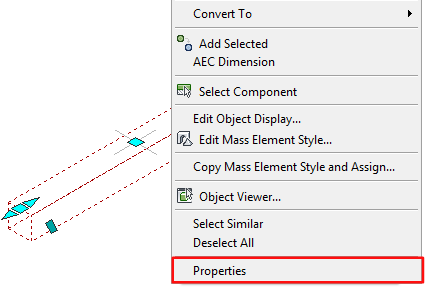

- In the drawing, right-click the beam and select Properties.

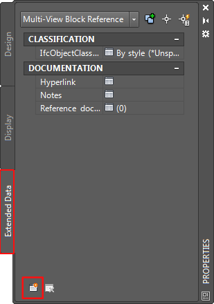

- In the Properties palette, on the Extended Data tab, click the Add Property Sets.

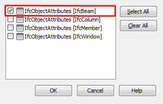

- In the Add Property Sets dialog box, select IfcObjectAttribute [IfcBeam] and click OK.
You can now assign specific IFC attributes for IfcBeam using the property set IfcObjectAttributes [IfcBeam].
