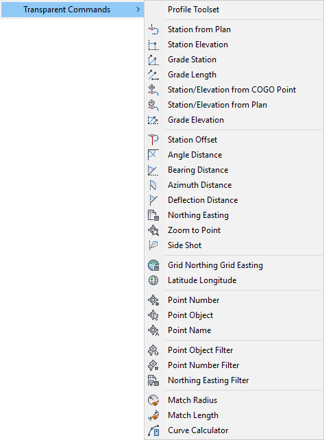

You can run transparent commands from the Transparent Commands ribbon tab, from the context menu, by using a toolbar or by entering a command.
Most Autodesk Civil 3D transparent commands are used to specify point locations within a larger operation, such as the creation of an alignment or a plot lot line. Using these transparent commands, you can calculate the location for a point from information, such as angle and distance or from point object information, such as a point number.
