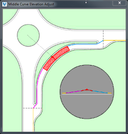

The Roundabout Properties Diagram is used to explain the terminology. Select the Diagram button to display it and click again to hide it. Clicking within different fields changes the display of the diagram to the selected parameter.
Diagram Display Example
