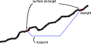

  • Surface: Specifies that the grading projection lines will be extended from the footprint until they match into a surface. You are prompted to select a target surface when you create a grading that uses these criteria.
    Click to view a surface as grading target (section view)

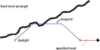

  • Level: Specifies that the grading projection lines will be extended from the footprint until they reach a specified level. Enter a positive or negative number in the Level field.
    Click to view level as grading target (section view)

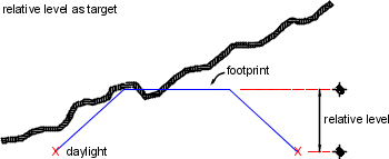

  • Relative Level: Specifies that the grading projection lines will be extended from the footprint until they reach a level (depth or height) relative to the footprint. Enter a positive or negative number in the Relative Level field.
    Click to view relative level as grading target (section view)

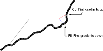

Specifies whether to search first for cut or fill slopes in cases where both would work. For example, where the target surface has a steep slope, both cut and fill slopes may intersect the surface.
  • Cut First: Creates the grading by trying to gradient up from the footprint. If no solution is found, it will gradient down.
  • Fill First: Creates the grading by trying to gradient down from the footprint. If no solution is found, it will gradient up.
Different results achieved based on Cut First and Fill First settings (section view)

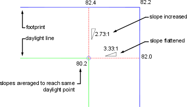

  • Use Average Slope: Averages the slopes to reach same daylight point.
    Click to view how this option is applied

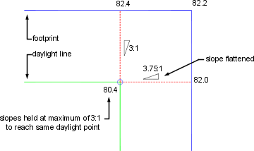

  • Hold Slope As Maximum: Holds the specified gradient or slope as the maximum and flattens out the slope projected from the footprint on one side.

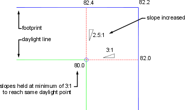

  • Hold Slope As Minimum: Holds the specified gradient or slope as the minimum and increases the slope projected from the footprint on one side.
