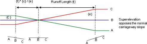

This example shows an undivided planar road. The carriageway is not crowned, and there is no adverse superelevation applied from low channel.
The Planar attainment method requires two formulas: one for curves that oppose the direction of the normal crossfall and one for curves that continue in the direction of the normal crossfall. The following illustration shows normalized slope superelevation, where the unsuperelevated road is tilted downward from left to right. Therefore the curve to the left requires a longer transition than the curve to the right:
In the following example, the Continuing section defines the Normal Crossfall to Full Superelevation distance runoff length {t} (derived from the transition length tables), minus the runoff length times the balanced carriageway slope {c} divided by the full superelevation rate {e}. The second formula defines the distance from Normal Crossfall to the Beginning of Curve as a percentage of {t} based on the variable {p} minus {c} divided by {e}.
The Opposing section defines the overall transition distance to be the runoff length {t}. The distance to the Beginning of Curve is a percentage of {t} based on the variable {p}, and the distance between the Normal Crossfall and Level Crown chainages is {t} * {c} / {e}.
