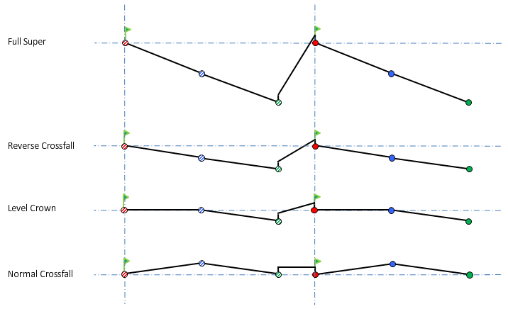

In dual carriageways, there are typically two options for superelevating each side of a dual carriageway.
Maintain Central Reserve Shape means when superelevation is applied, the central reserve raises to accomodate the superelevation. This option maintains the central reserve shape, and the
pivot points raise or lower.

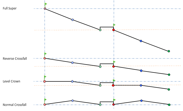

Distorted Central Reserve means when superelevation is applied, the central reserve width remains that same, but either side raises or lowers to accomodate the superelevation. This option distorts the central reserve shape, and the
pivot points maintain their original position.
