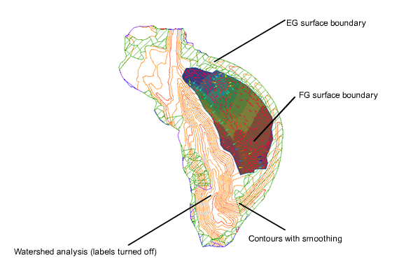

Boundaries define the visible area of a surface. Only the area within the boundary is included in calculations, such as for total area and volume. You can also define masks to hide or show parts of a surface for editing or presentation purposes, while still including that area in calculations.

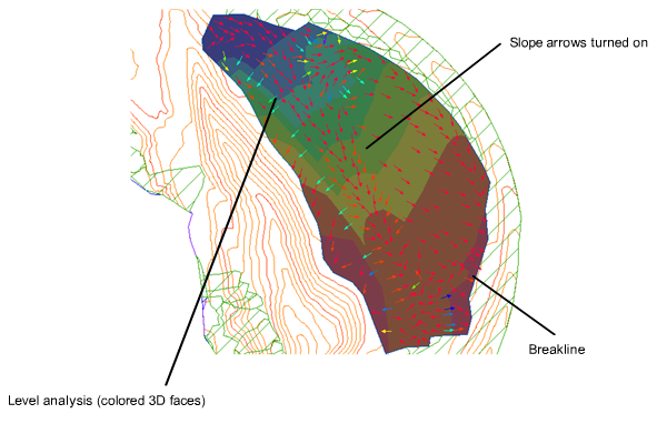

Surfaces displaying boundaries, contours, and level analysis

Surfaces displaying slope arrows level analysis
