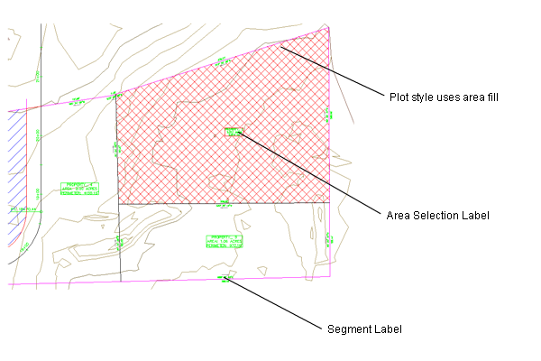

There are separate label styles for plot areas and plot segments.
Plot display style and two types of label
