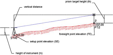

The vertical distance from the scope center to the EDM center. Autodesk Civil 3D uses this value to calculate distance.

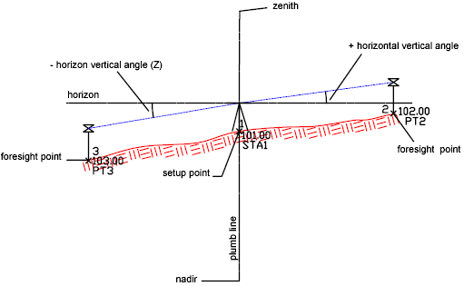

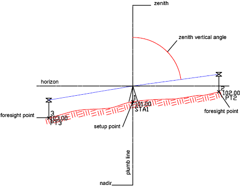

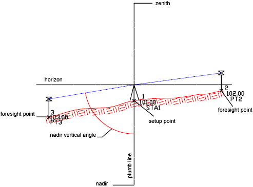

The nadir angle is opposite the zenith.

The vertical distance between the theodolite target point and the optical center of the reflector.

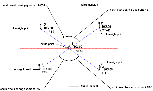

One of the sections resulting from dividing a circle into four equal parts. Quadrant 1 is the NE corner, and quadrants 2, 3, and 4 proceed clockwise around the compass. Quadrant bearings are usually referenced by quadrant number.
An angle measured from North or South, whichever is nearest, with the added designation of East or West. The angle is always less than 90 degrees (IP/2 radians or 100 grads) and is referenced by a quadrant number.

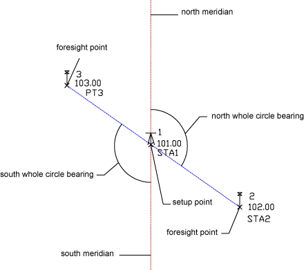

Whole circle bearings south of the equator are referenced to due South clockwise.

An angle above or below the horizontal plane. The angle is expressed in DDMMSS from this horizon. Vertical angles expressing a downhill slope from the instrument chainage are described with a negative value. Zenith angles are similar to vertical angles, except that a zenith angle has a vertical reference plane.

A clockwise angle measured from a reference meridian. Also known as north whole circle bearing. It can range from 0 to 360 degrees. A negative whole circle bearing is converted to a clockwise value.
