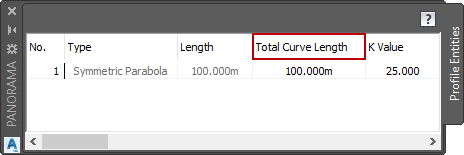

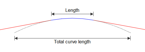

The Total Curve Length value shows the total vertical curve length, whereas the Length property shows the length of the solved portion of the curve geometry, such as when straights are attached along the curves.
You can edit available parameters by clicking in the Value column. If a parameter is uneditable, its name and values are displayed in a gray color.
