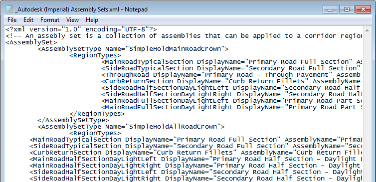

| assembly set file | An .xml file containing information that defines the assemblies that are included in an assembly set. An assembly set file contains the names of the assembly objects, the location (path) where the individual assembly drawings exist, and other information about the assemblies included in the set. This .xml file serves primarily as a pointer (reference mechanism). It does not contain the actual assembly drawing data. |
| assembly object names | The name of each assembly object referenced in the set is maintained in the assembly set file. Note that the assembly object data itself is not contained in the assembly set file, just the information that enables Autodesk Civil 3D to locate the assembly object data (a reference to the assembly name, and the name of the drawing file that contains the assembly object.) |

The following illustration shows the contents of the default assembly set file that is included with Autodesk Civil 3D.
