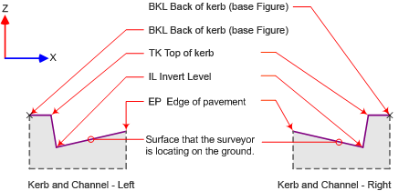

The following illustration shows an example of feature definitions:
The following illustration shows these feature codes:
