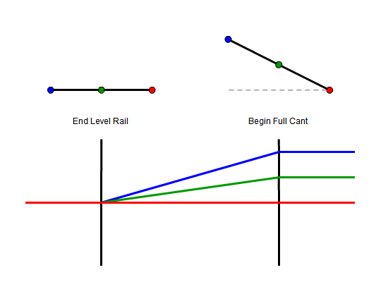

The following illustration describes the Low Side Rail pivot method for a single track railway.

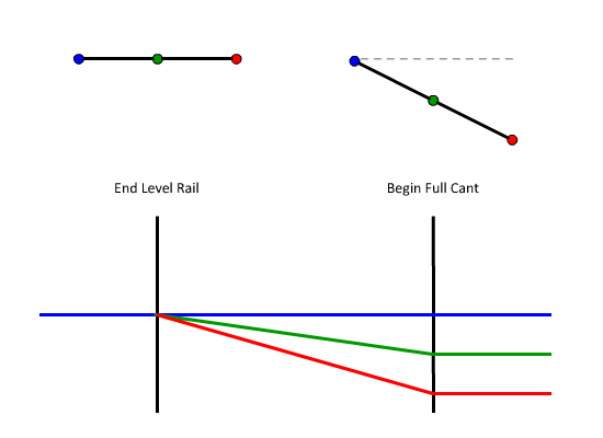

The following illustration describes the High Side Rail pivot method for a single track railway.

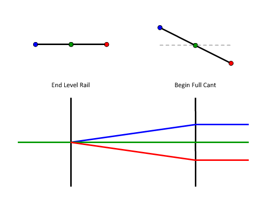

The following illustration describes the Centerline pivot method for a single track railway.
