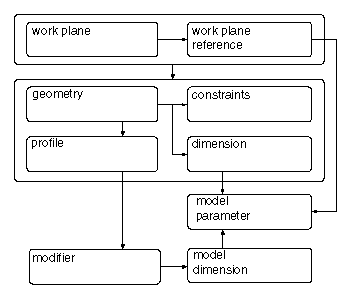

The following illustration shows the features that make up the model. Arrows indicate the direction of the relationship between features. For example, modifying geometry affects a profile, which affects a modifier, and so on. Refer to this illustration as you learn more about each feature to help you understand the relationships between features.
