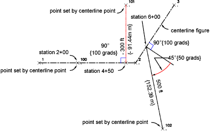

You can create a new point using an offset from a station on the current centerline.
Chainage/Offset. CL TP (point 1) [station] (offset) (skew angle) (description)
BEGIN CL1
NE 1 1000 1000
NE 2 1000 1500
NE 3 1300 1700
END
CL IS CL1
CL TP 100 200
! POINT 100 NORTH: 1000.0000 EAST: 1200.0000 LEVEL: <Null>
CL TP 101 450 -91.44
! POINT 101 NORTH: 1091.4400 EAST: 1450.0000 LEVEL: <Null>
102 600 152.4 50
! POINT 102 NORTH: 931.7283 EAST: 1572.2198 LEVEL: <Null>
Point 100 is located at station 200 with a zero offset. Point 101 is located at station 450 with a left offset distance of 91.44. Point 102 is located at station 600 with a right offset distance of 152.4 and a skew angle of 50.
Centerline point created by a station offset
| Parameter | Definition |
| point 1 | The point identifier for the new point. You do not need to assign a point number if auto point numbering is on. |
| station | The station at which to set the point. |
| offset | An optional component that specifies the distance from the centerline to the new point. A negative offset sets the point to left of the centerline, and a positive offset sets it to the right. |
| skew angle | An optional component that specifies the clockwise angle to skew the point from the centerline to create non-perpendicular offsets. Type this value in the current angular units (DMS, grads, decimal degrees, radians, or mils). |
| description | An optional description associated with the point. |
