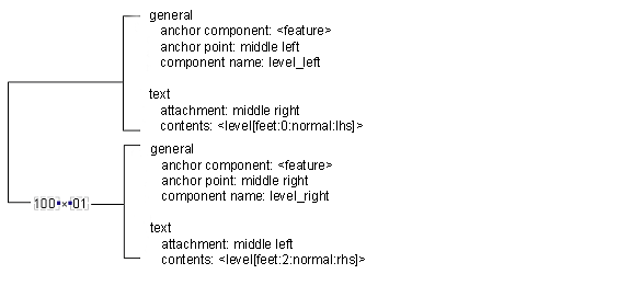

The spot level label style is configured in the Label Style Composer. When a spot level is created, the command can specify an existing point style and label style at create-time, or a block can be specified in the composition of the spot level label style.
The following examples illustrate a label style that can label a spot level at the level decimal point. The decimal point of the spot level value is represented by a block, or a point style specified at creation time. The labeled level consists of two subtext components in the label style, each with different properties:
